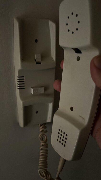

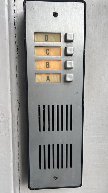

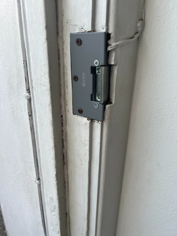

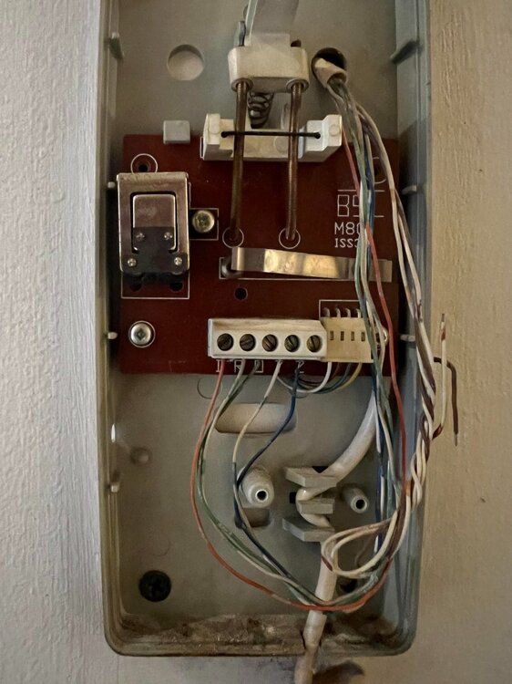

May 31, 20242 yr 18 hours ago, Secware_Tech6 said: Hi Eric What system do you have currently and how is is cabled / wired. ie what type and size of cables run where? Hi, Can you assess the imagery I am attaching to this thread please? All I know is that it is a 4 station Bell Systems audio only intercom system which was installed in my family home in 1994. It has been very reliable but has encountered some handset and audio quality issues over the past 2 years. I would therefore like to know if the current Bell BS4 4 station video system you have online below can be able to be installed and effectively upgrade what I have described above? https://www.securitywarehouse.co.uk/catalog/access-control-c-27/video-c-27_34/bell-bs4-bellissimo-4-station-video-system-p-6296.html Thank you, Eric
May 31, 20242 yr Author My initial concern is that BT cable isnt ideal for Video but OK for audio. Looking at your images it isnt cat5 cable. You me be better with a 2 wire system depending on the ranges involved I assume you have standard parallel audio (ie call is seperate but audio is common. If your having issues on that cable with audio only video and audio is highly probably to be an issue
