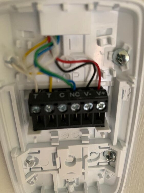

  2. OMG Sorry forget the last couple of messages from me. On closer inspection l realised l had one of the tamper and one of the circuit cables round the wrong way on 2 zones. I have now put them the right way round weirdly the alarm was working fine. However l have done what you asked me to do last night and now the alarm will set (connecting the circuit wires together in PIR) I have also checked all the wires in the panel with a meter and none are damaged. I have also swapped the fronts of the PIR's and still have the same results. So do you think its the back section of the PIR? Sorry to bother you again Regards Darren

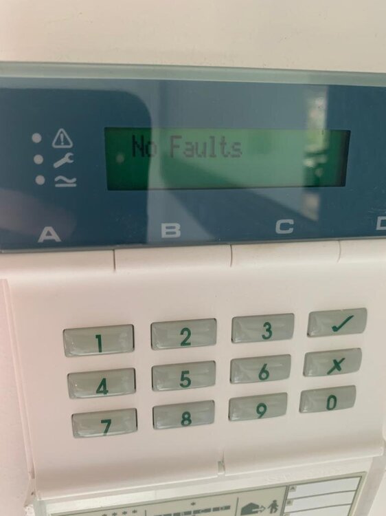

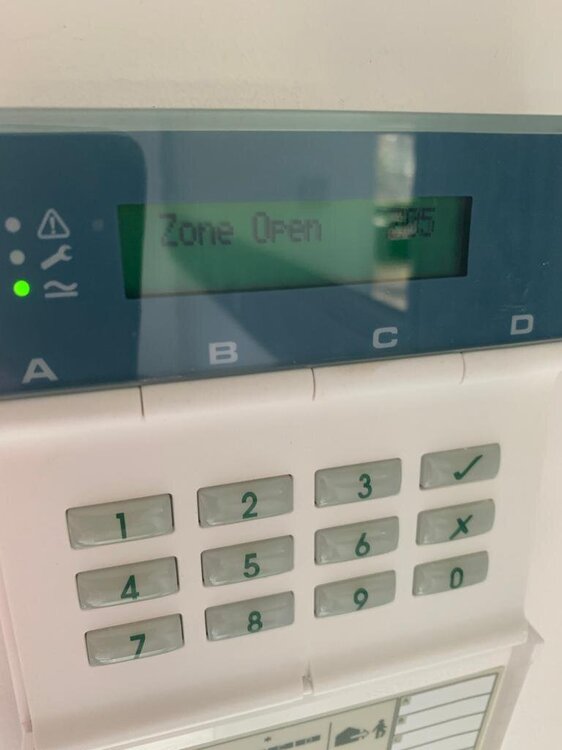

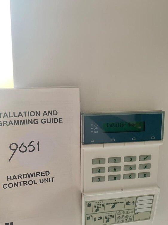

  5. Also after l sent you these pics l came out of installer mode and these are the messages on the keypad first no faults when l put the control panel lid back on then went to set the alarm and received the open zone message. Although the PIR sensor led is working normally the paneldoes not pick up the sensor on a walk test. This morning l have done what you asked and sent a pic. When l closed the PIR and tried to set the alarm it said zones 5 and six are open and although led's are working on both zones neither are picking up on a walk test. Hope this helps Regards Darren

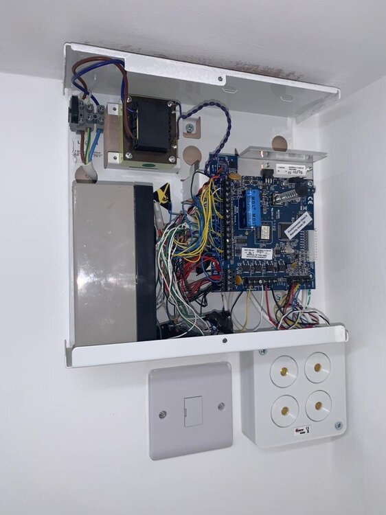

  6. Hi thanks for the quick response. I have attached a couple of pics to help. Nothing has changed since l installed it exactly 1 year ago. It has been working completely fine. So l'm hoping to rule out cable damage. Scantronic 9651
