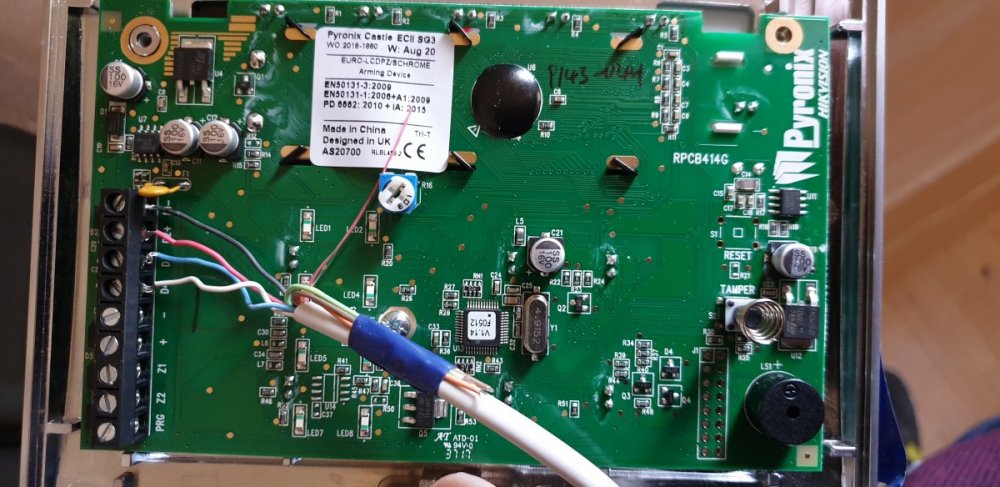

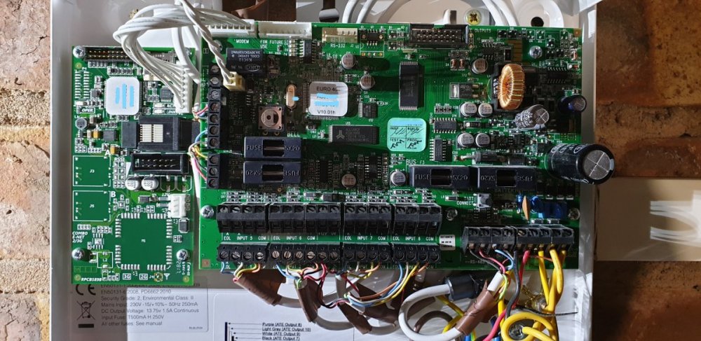

  2. Hi all I received my exchange from yourselves and today installed the new unit. The keypads now turns on unlike before. Just to recap i have connected to the system 3 x Pir`s and 1 door contact. 1 x 16ohm external speaker connected to the system 1 x Keypad connected to the system. 1 x Lan card connected. I turned the system on for the first time there were no sounds and the keypad behaved as expected. The Keypad states Euro 46 but not Euro 46 V10 like in the manual also the time and date adjusted itself, i assume this is because the Lan card is installed and had connection to the internet? More importantly i started to go through the menus to start to configure the system. I press the D key and type in the default engineer code. The keypad then shows, SET SYSTEM, and when i scroll through FORCE ARM ON 1st INPUT but as i go to scroll through again the keypad returns to the normal screen with euro 46 and the time. The manual stated that when in engineer mode a warning light should light up and an audible noise Should be heard every so often - This is not the case. Also when in the engineer menu if i dont press anything it will return to the main view with time showing. I then tried to enter the master manager menu, again pressed D and entered code. I start to scroll through and notice there are menus missing e.g choose mode, system options, communications there are more but wont type them all. All the menu`s i see are, set date and time, operate user outputs, omit inputs, edit users, review logs, walk test, siren test, dial out menu, allow engr menu, block remote set?, block udl, system sounds demo and exit manager menu. I have gone in to the allow engr menu and it says yes, I understand that on your website there is stock issues regarding a recall about the software which is on the panels, do my problems above refer to the issues that pyronix are having? Please could you advise me on what i am doing wrong or what the issue may be? I have not changed any settings at this point. Please could you advise me on what i am doing wrong or what the issue may be?

  4. Hello sorry took me a while to reply. Just measured fuse and set multimeter to 200ohms which is my continuity function and get reading of 0.5. I have found 2 fuses that came with the alarm and measures all and all have continuity. All measure the same value. The fuses are F800ma I decided to remove the fuse from the bus holder and just measure accross the pins where the fuse fits and and i get 12v. What I dont understand is why ain't I getting 12v at the terminals d1 and d2 on the pannel.

  9. Cable continuity is fine. I've measured d1 and d2 on pannel and there is no power at the connections on the 485 bus
  10. Yes that was a quick pic as I was changing keypads over. The keypad was temporally connected to see if it lights up and it did. Its not connected back to the pannel. I was un sure if I had faulty keypad or a faulty pannel. I stated in the post all fuses are working ok. I used continuity tester to test them. I have no issues with the sensors but wanted to Express how they system is behaving.
  11. Hi all, purchased this from security warehouse last year and just got round to installing it. I have wired up all sensors - 3 Pir`s and 1 door contact. I have an 16ohm external speaker connected to the system I have 1 Keypad connected to the system. 1 have one Lan card connected. I turned it on for the first time and i hear a time which confirms it has been turned on. I expect the keypad to light up but there is nothing from the keypad. The keypad does not light up. I have read if i hold down the D key it allows you to select the address and there is no response from either the one supplied with the system or the flush keypad i purchase additionally. After literally 2 mins, i had a constant beep, beep,beep start lasting about 2 seconds at a time and is continuous. All my Pir`s seem to behave as expected and the outside bell box is not going off but has the 2 lights that flash from side to side going. I have checked the cable which i have run and all the wires are ok and not broken. I am not getting 12v at the keypad. When i measure the board on the to terminals which supply power to the keypad there is no voltage. D1 and D2 if i remember correctly. I decided to connect the keypad direct to the battery and the keypad lights up. When wiring up the Pir sensors i opted for the NC option in the manual. also i noticed when i removed the external casing the tamper does not activate no alarm goes off. I have checked all fuses and they all work. Below are pictures of how it is wired up, main board and the kaypad. Please can someone assist me as i am unsure of why the system is doing this.
